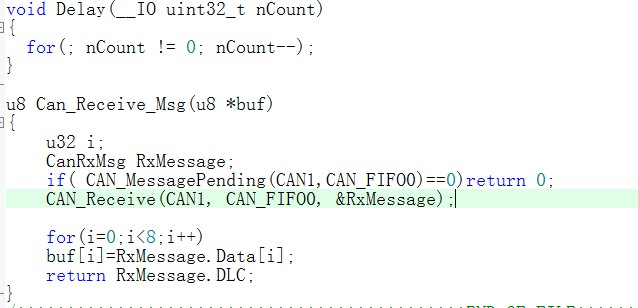

..\..\Output\SPI_FLASH.axf: Error: L6200E: Symbol CAN_Receive multiply defined (by main.o and stm32f10x_can.o).
Not enough information to list image symbols.
Not enough information to list the image map.
发表于 2018-5-3 10:05:59 | 显示全部楼层
把其中一处的定义删除掉
