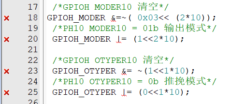

完全按照野火开发板实战指南里的一步一步做的最简单的练习:用寄存器点亮LED
发现一个自己无法解释的问题,求帮助:
.h头文件里已经用宏定义了寄存器,但在主程序里,keil提示,这些宏定义的寄存器不能赋值。
仔仔细细检查过,和指南里完全一样,不知道问题在哪里。

提示在哪里?  那个红色的X不算,看不出问题?有编译过吗?编译有错误提示吗?
其实都是同一个错误 error: expression is not assignable
*** Using Compiler 'V6.10.1', folder: 'C:\Keil_v5\ARM\ARMCLANG\Bin'
Build target 'Target 1'
assembling startup_stm32h743xx.s...
main.c(13): error: expression is not assignable
RCC_AHB4ENR |= (1<<7);
main.c(18): error: expression is not assignable
GPIOH_MODER &=~( 0x03<< (2*10));
main.c(20): error: expression is not assignable
GPIOH_MODER |= (1<<2*10);
main.c(23): error: expression is not assignable
GPIOH_OTYPER &= ~(1<<1*10);
main.c(25): error: expression is not assignable
GPIOH_OTYPER |= (0<<1*10);
main.c(28): error: expression is not assignable
GPIOH_OSPEEDR &= ~(0x03<<2*10);
main.c(31): error: expression is not assignable
GPIOH_OSPEEDR |= (0<<2*10);
main.c(34): error: expression is not assignable
GPIOH_PUPDR &= ~(0x03<<2*10);
main.c(36): error: expression is not assignable
GPIOH_PUPDR |= (1<<2*10);
main.c(39): error: expression is not assignable
GPIOH_BSRRH |= (1<<10);
10 errors generated.
compiling main.c...
".\LED-REG.axf" - 10 Error(s), 0 Warning(s).
Target not created.
Build Time Elapsed:  00:00:01
