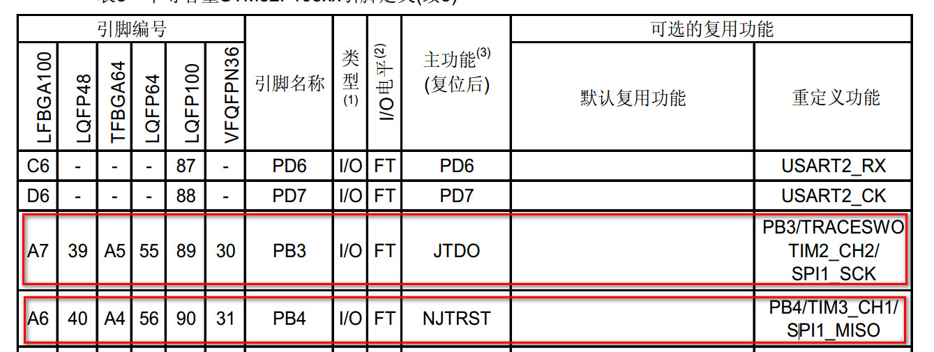

如图所示,想把PB3、PB4当成普通的IO用,应该怎么去配置呢

https://blog.csdn.net/baidu_15051639/article/details/78895064
RCC_APB2PeriphClockCmd(RCC_APB2Periph_AFIO|RCC_APB2Periph_GPIOB, ENABLE);
GPIO_PinRemapConfig(GPIO_Remap_SWJ_JTAGDisable, ENABLE);
这样就行
